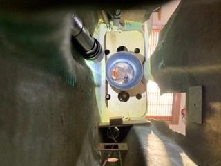

I think that the turbine or pipe should be closer together , it should be like 1/2,5” from the actual pipe not the bell lip.

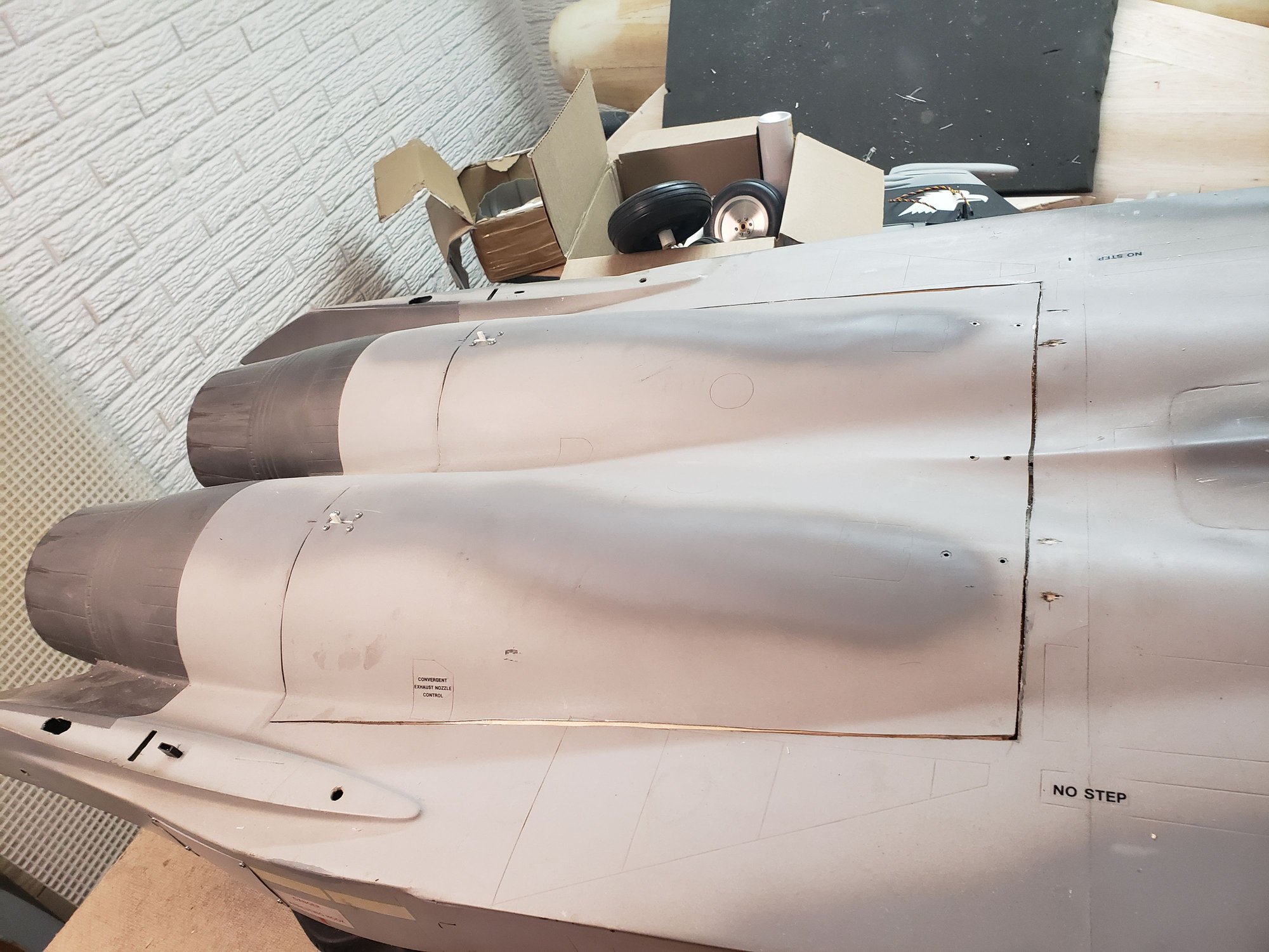

Well took 2 days But had to completely change the top hatch operation. The skin by it self is like paper.
So I needed to add support from the 2 formers, so I used 2 1/4in hard wood to attach both formers and help build the 1/4in deep inset for the hatch to recess to This let's me build 1/4in (3/16) ply formers. Added some carbonfiber as this section is to close to pipe for a former
Also add 3 front in incerts, rods.to secure the front part. This makes the hatch stronger and the fuse is now stronger
I use servo eyes for all pins that go into wood to prevent the wood hole from getting bigger

Mike, you're a lot farther along than I am. Shown here is my rear former for the bifurcated pipe. Apparently my pipe is a lot longer than yours is. (I hate the way that sounds). My engine will sit almost between the main gears. There are advantages and disadvantages. The upside is my thrust tube bellmouth has plenty of vertical clearance, so no flat spot needed. The downside is fuel tank location. I also have a 2nd former with one hole that supports the tube forward of the split. Are you putting any heat reflecting material inside?

Your right, If it was up to me, I would of put the motor farther forward, but someone else already cut the back hatch and got the pipe, so I worked with what I had.
I will add heat alum tape, with some of the BVM white heat paint on the top hatch over the heat tape, there is a small former in the center of the Y pipe, I will screw a thin sheet of alum on it incase the Y pipe burns a hole in the middle, along with a coating of the BVM heat paint, My fear with Y pipes are potential failure in flight, but if it happens you will hear it but you will only have a few sec to turn off motor before major issues. The BVM heat paint will give a few sec of protection, as for the rest of the fuse, is so far away from the pipe I don't see there being any issues, Pulse the way I have my turbine mount, there is light ply under the motor in the hot spot under intake bell.

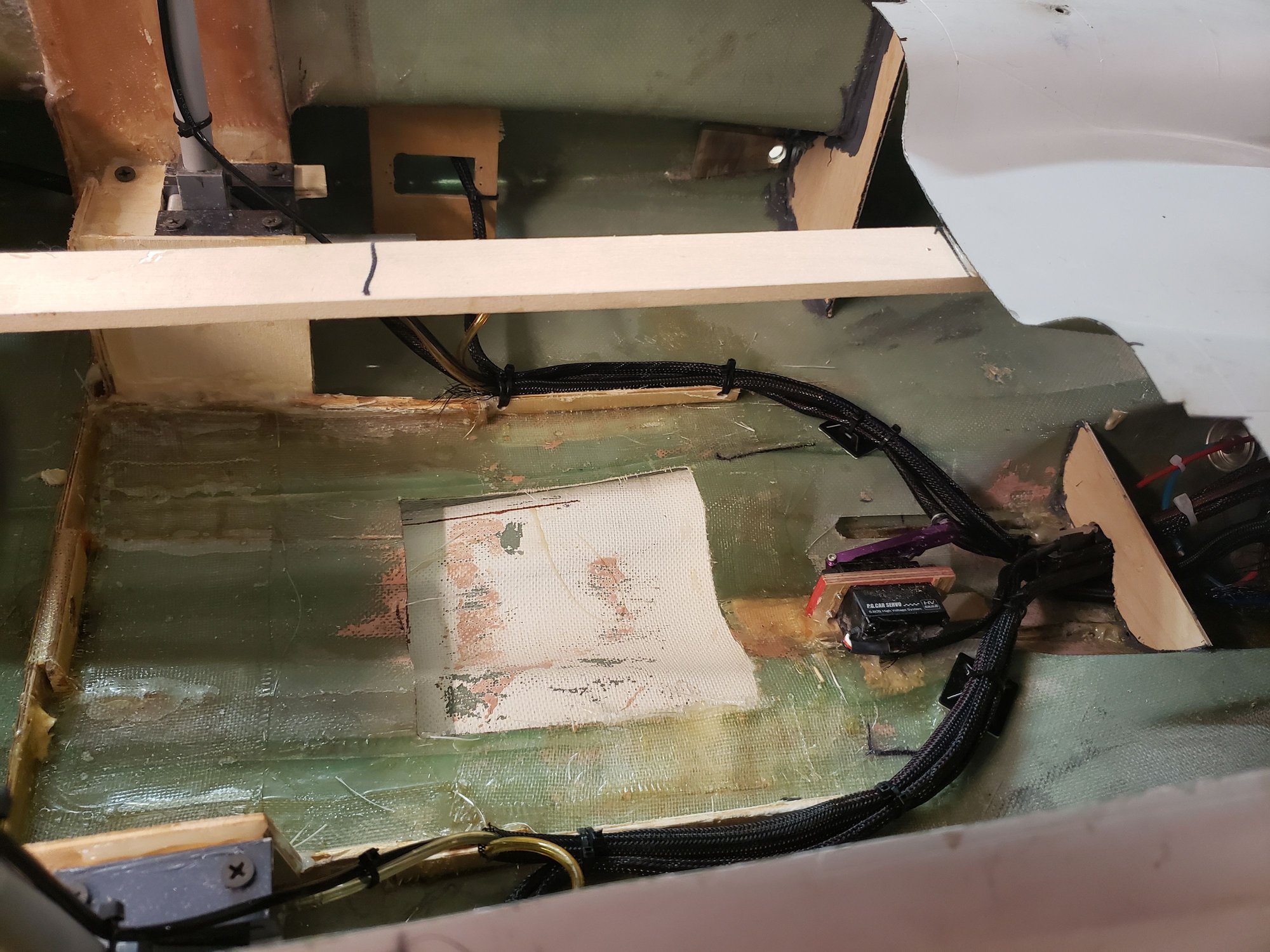

So wireing harnesses and air harnesses are done, all net, as and covered in sheath to protect wires and hoses

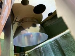

Aluminum heat shield on the only part that will be close to the pipe, and radiates up. Made out of thin aluminum with 4mm wood spacers glued to top hatch
Fuel tanks were done a few days back Used 1/4in ply strips to build a frame around the new Dubro 80oz fuel tanks, I used plastic epoxy to help secure it to frame along with silicone, once I'm done on inside it will get set in with the 3 mounting points being glued for easy removal buy 3 screws
Built a 1/4 in ply box with 3/16 support former to hold the 10mm 2nd wing spar. Moveing foward.

Nice heat shield , will stay there and do the job.

I would move the pipe forward a tad, Make the tail pipe flush or a tiny bit inside the fuse, I don't have a single just that the pip actually sits out like that. Pulse with the huge outlets we have there is still a good distance between pipe and jet, I will put a strip of super thin aluminum flashing held on by Goop or Silicone to hold in place incase I have a odd hot/fail start.

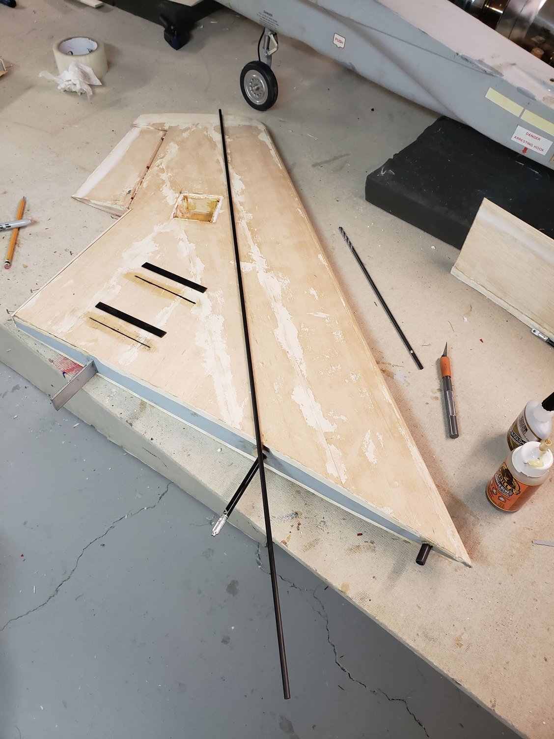

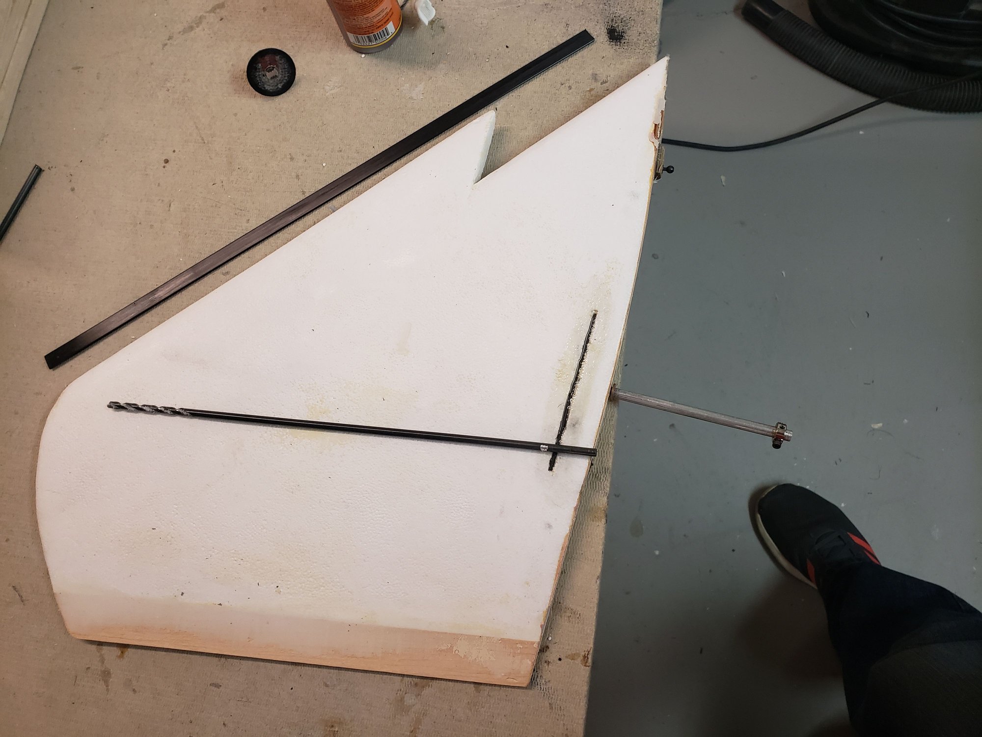

So used my drill bit to get holes for carbonfiber rods nice and straight, then put rod in drill, and drilled it all the way in.
Then cut channels in for carbonfiber flat peaces with groves cut in to cradle Aluminum in elevators and flat wing tub.
Cut flaps off, now time to shape them
